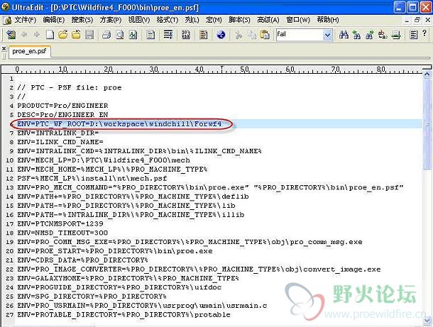

The other way is to add system environment at Pro/ENGINEER Wildfire 4.0 startup command.
>> Open the Pro/ENGINEER startup file .psf (at <proe_loadpoint>\bin folder) with wordpad, add a line "ENV=PTC_WF_ROOT=D:\workspace\windchill\Forwf4", the value D:\workspace\windchill\Forwf4 is the path for writing cache. (Refer to bellowed picture)

用记事本打开 Pro/ENGINEER4.0 启动文件 proe_en.psf (在 安装目录\bin 文件内),增加一行:"ENV=PTC_WF_ROOT=D:\workspace\windchill\Forwf4"
值 D:\workspace\windchill\Forwf4 是要写入缓冲文件的目的文件夹,参照下图。

proe_en.psf内容
proe_en.psf内容
