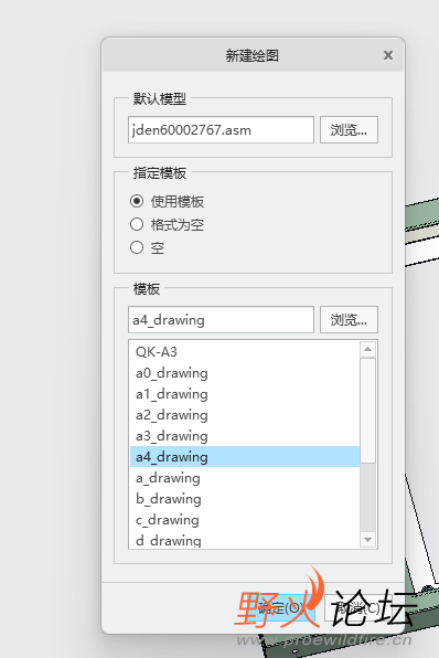

[求助] frm文件中的图框线条到工程图中不显示

问题已经解决,
在config中,加入一句
pro_format_dir D:\creo_standards\formats
借鉴的原始的config
  1. ! ***** Library Paths/Locations *****
  2. !
  3. mdl_tree_cfg_file $pro_directory\creo_standards\config_files\tree.cfg
  4. pro_format_dir $pro_directory\creo_standards\formats
  5. pro_library_dir $pro_directory\creo_standards
  6. pro_material_dir $pro_directory\creo_standards\material_database
  7. pro_symbol_dir $pro_directory\symbols
  8. search_path $pro_directory\creo_standards\formats\sample_formats
  9. search_path $pro_directory\creo_standards\formats\dte_formats
  10. start_model_dir $pro_directory\creo_standards\templates
  11. trail_dir $TEMP
  12. !
复制代码
即将frm模板文件的路径指明才成。
