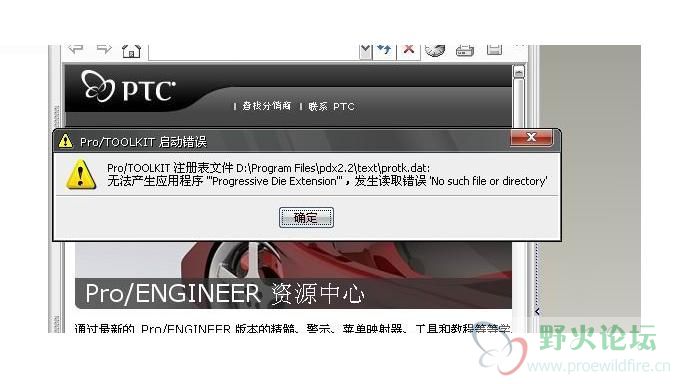

为什么在PROE4.0上的PDX2.2安装出错!请高手指教!!

发表于 2009-4-28 08:52 | 显示全部楼层
要把  protk  修改
name "rogressive Die Extension 5.0"
exec_file D:\cax\ptc\pdxRelease 5.0\$PRO_MACHINE_TYPE\pdx50_wildfire4.dll
text_dir  D:\cax\ptc\pdxRelease 5.0
revision 2001
startup dll
description "DX 5.0 F000"
end
装5.0吧!最新
